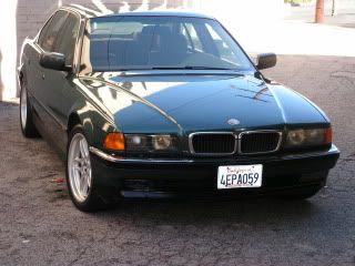

On a happier note, Frankie got a very good cleaning while in LA, the car wash place was incredibly thorough. Frankie also stopped by the Pasadena Rose Bowl in preparation for the upcoming Bimmerfest which I hope some of you will attend. Here is Frankie giving you all a Big German Hallo !!!
Her Big 200K Moment (Engine only has 90K since rebuild)
Post Car Wash pics - The new 275/ 40 rears look much better.
