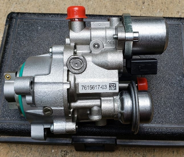

My high pressure fuel pump recently gave up the ghost at 148,555 miles.
I found an excellent how-to video on YouTube on replacing the HPFP. The video was posted September 21, 2020 and the guy added links to parts and mentioned the OEM HPFP was $339.
But apparently in the past year the price has more than doubled to $720. Not sure if it's the pandemic-related price increases of supply, demand, labor shortage, etc., or what.
$339 was a no-brainer. $720 put me at a point where I was willing to take a gamble on an aftermarket part. If it turned out to be a bad decision I'd chalk the loss up to experience and get the OEM.
I searched the web for any info and recommendations I could find on the best aftermarket HPFP. I never found anything except dire warnings that they won't last. One site explicitly declared that an aftermarket part will absolutely not make it past 1,000 miles.
Still, I was determined to take the gamble. With no advice to be found on which one to buy, I went by pure sales numbers shown on eBay. Which one sells the most? I settled on one but bought it through Amazon for $179.
Installation was painful but mostly because I was in very unfamiliar territory. I've never taken a vehicle apart to the extent required for this job. I feel confident if I had to do it again ot would be much smoother.
Anyway. I'm posting this because I replaced the HPFP 7 weeks ago and just turned over 1,000 miles on it a few days ago. It's working great and so far I'm very happy with my decision.
Some links....
The HPFP:
The how-to video I followed:
If I have to do it again I would first buy this set of 5mm Allen wrenches (the pump is secured by 5mm bolts):
Photo of the new pump below. It appears to be a remanufactured OEM pump. It looks like there's even some JB Weld securing that part in the lower right.

I too just ordered one of these OSIAS pumps (7615617-01 for me).
Has your pump been reliable?
