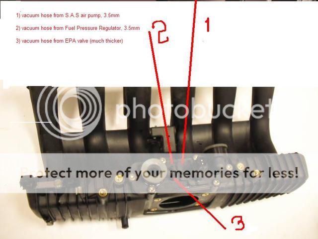

Line photo
Hopefully this will be clear. The two vacuum lines should show on the left, then you can just make out the black tube to the right of them (assuming the photo doesn't flip-flop) It disappears past what I think is the CCV. It sure looks like it should attach to something. The piece that's stuck inside the rubber on the line is red plastic and looks to have broken off something, but I can't find anything.
Additional info: The line is the one immediately to the right of the vacuum line with the blue stripe. It's more of a plastic line than normal vacuum lines. It's stiff material, not rubber. In the photo you sent, I don't see the line. The engine is a replacement after the kid I bought the car from had smoked the original one racing with an add-on manifold that sucked too much air (If I remember right), so this line could be from something and was dead-headed.

I installed a new cold air intake on the E36 the other day and decided to take another run at the mystery hose from these conversations. Remember that this car has a replacement engine, so I don't know the configuration. After looking at numerous commentary and repair docs, the best guess is that this vacuum line connects to a nipple on the intake manifold as shown in one of the photo diagrams in the threads. The other end of the line should attach to the fuel pressure regulator, but there isn't one in any of the M52 fuel rail locations I've seen listed....and the line is only long enough to go to the front or rear of the fuel rail. As there have never been any issues with idle or running, my conclusion is that the engine may be an M52TU or M54 (assuming they fit) with the pressure regulator under the car...not on the fuel rail. When the engine was replaced, they may have used the old intake manifold, attached the vacuum line, then found they had a different configuration, so just left the line and plugged it. again, I have no problems with acceleration, idle, starting, etc. She runs fine. Still no answer to the recurring P0455 code, but it doesn't have any noticeable effect of performance. While searching for anything that might plug into the line, I did find a flexible bit of rubbery, circular material that may have been used as a gasket for the intake manifold when it was installed. It appears to not be completely under the manifold, which might explain the code, but I'm not ready to tear into an engine that's running well to test a theory. Next step is to hunt for the engine numbers so I can find out just what I have.
