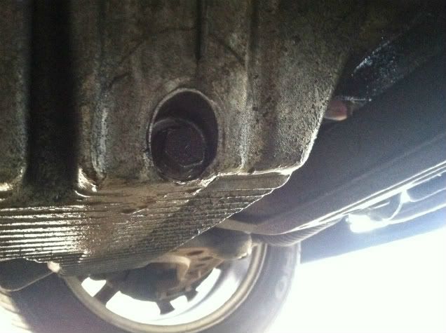

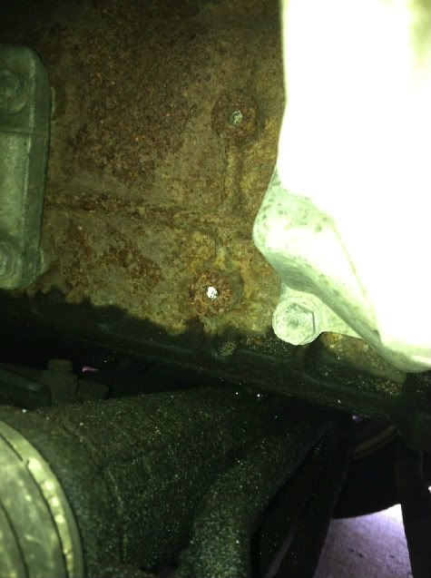

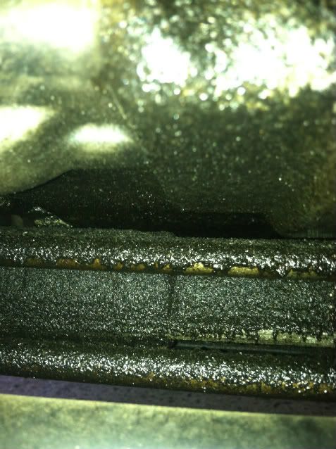

I recently started noticing some oil drops in my driveway. I jacked the car up and it really looked like a mess, but I cant figure out whats leaking. Does this look like the oil pan gasket to you? I thought the drain plug was stripped at first, but that doesn't explain the dirty steering rack. I know the power steering lines are leaking. It couldn't all be blow back from that could it?
Ill be washing down the whole underside with simple green later today. Just figured Id post up on here to see if anyone had any advice for what to look out for while Im under there.

Although the oil pan gaskets can leak on occasion, the E36 engines are not known for having oil leaks very often (with the exception of the valve cover gasket). That said, the E36 is notorious for having leaking/weeping power steering hoses. Since you said your steering rack is drenched, there is a 95% chance that this is the source of your leak, not the oil pan gasket, and fluid from the steering system is dripping down and blowing back onto the oil pan (and everything else).

Thanks,I'm hoping thats what It winds up being. I won't be home for a while, but Ill check to see what kind of fluid is on the bottom of the oil pan before I rinse it off. Theres so much sludge toward the front of the engine its hard to tell anything in that area!

Thanks. Turns out it was the oil pan. Not surprising with 240k and completely unknown history. Doesnt need to last me too much longer for DD duty anyway. Itll just do autox's after that.
