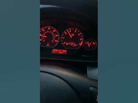

This horrible noise started during a recent cold snap and has continued even after the weather warmed up above freezing. It occurs primarily when the engine is cold or warming up, under constant throttle. Noise goes away when I lift off the throttle. 2004 325ci, manual, 121000 miles. Anyone have an idea what is causing this? Thanks in advance!

The only thing I can think of that functions in response to intake temperature is the ICV.
Maybe there's a combination of factors like ICV position and intake flow rate.
A bit like blowing over the top of an open bottle. You only get a sound if you blow at a certain speed and a certain angle.
I just noticed in your video that the engine is till in the process of warming up and the ICV might be in play at that time.
Maybe it's not moving the way it should. A bit sluggish because it needs cleaning.
Bit of wild one I know. When was it last cleaned?
That makes sense. Yes, it occurs more when the engine is cold. In very cold temps (16 degrees Fahrenheit), it occurred even after running for 15 minutes. But does go away after longer drives which would obviously warm up the engine more thoroughly. Regarding the last time the ICV was cleaned, that would be…never. I’ll look at that this weekend if we get a break from the rain.
