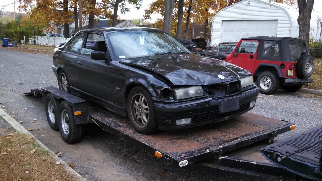

Buying a 1995 325i 5 speed parts car tomorrow for $800, M50 and the getrag are going in it. I already have a M50 midpipe with two good cats and a good O2 sensor, just need a muffler which will be aftermarket obviously.

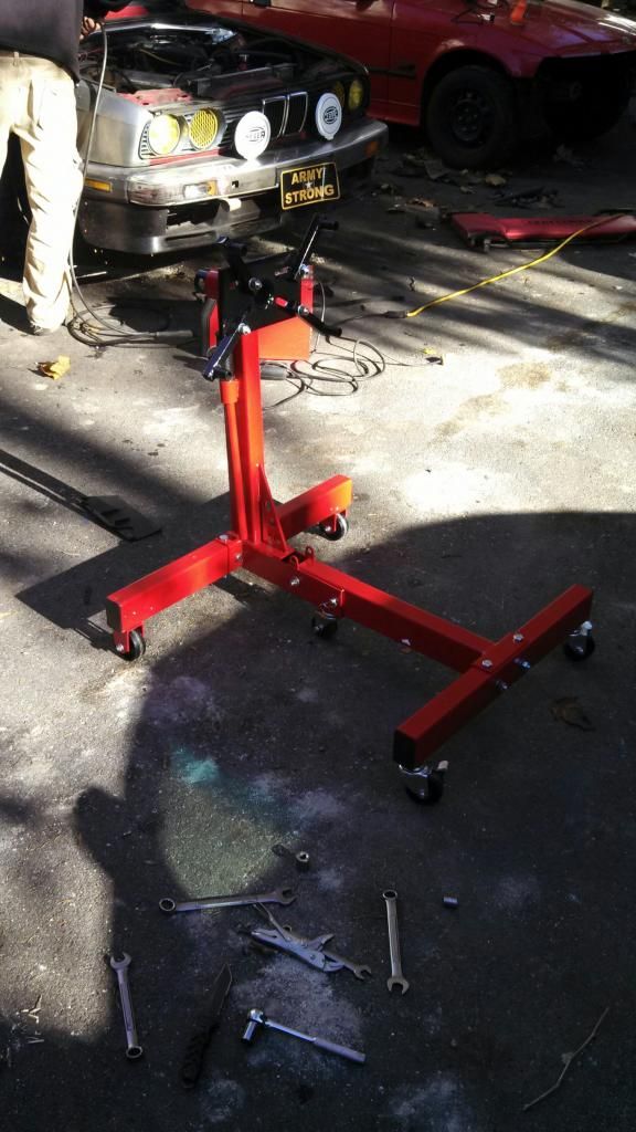

So today I bought myself a new toy, a 1500lb engine stand.
And I pulled out the M50

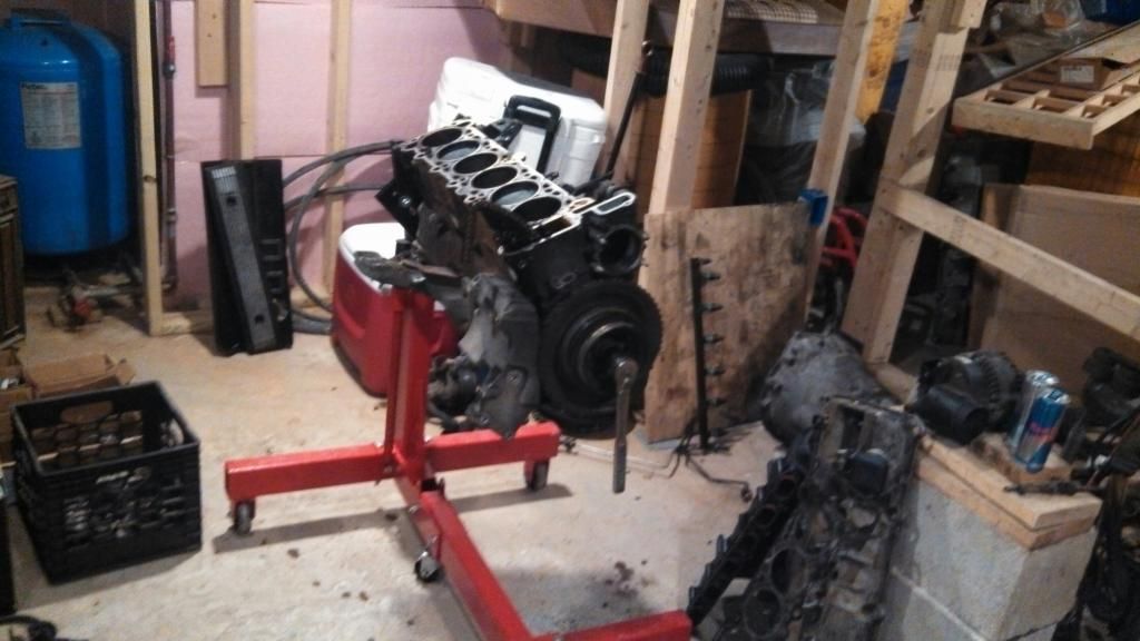

Get the cams out and the head pulled today. Pic's later. HG was good, head looks great, coolant passages look crazy good, cams were good, though the piston tops had a a lot of carbon.
Currently looking for a M54b30 crank and pistons. And S50 cams. Gonna make it a stroker.
