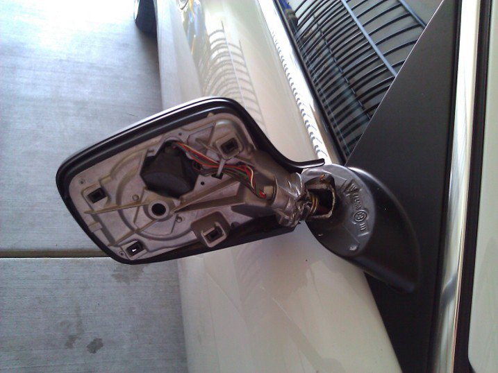

Taking the kids to school this morning and was distracted by my kids not listening when backing up the car and ran into the garage.
1,688 Posts
ouch...you may be able to use some 2 part epoxy to fix the mount and not have to replace the entire mirror, or take it off and have it aluminum welded, as it looks to be aluminum.

I tried to use JBweld but it's kinda loose. Going to redo it. Doesn't work, looks like a new door mirror out of pocket. Sad sad day.

JB weld is generic...see if you can find something specifically for aluminum, lowes and home depot usually carry different lines of epoxies.

It's hard to fix to cause the mirror is spring loaded with the mount. When it happened, it's not longer aligned. Kinda have to mount it out of place. Which doesn't look bad but is loose. It just annoys me cause it could had easily been avoided and all of this didn't have to happen. Just venting...

Just buy another mirror, why buy an expensive car and glue bits together on it...Doesn't make any sense..

I would if i had a writeup, but all i did was drilled two screws from the inside of the plastic mirror housing into the black metal piece that is still attached to the frame of the car and it sat flush as if it was never broken, the only function you lose is the fold up mirror obviously.
the tools i used was two phillip screws, drill, and drill bits to drill through the metal black piece. took about 15 min.
OR you can do what a gentleman said before and buy a new mirror at about 1200-1300.

are you talking about the mirror only? because if so then thats ok, but he needs the entire assembly as you see it snapped at the pivot point, which is 1200 from the dealer i called myself and thats why i resulted in the fix i did.
