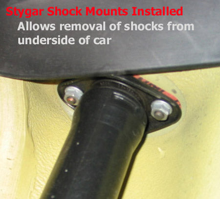

I want to mention right from the start that I did not document the installation of the rear shocks at all. I installed them just before Homecoming this past August and with everything we had going on, we were a bit pressed for time. I suggest taking the time to install Ron Stygar***8217;s Rear Shock Mounts. The stock shock mounts require that you disassemble the entire trunk area of the Coupe in order to remove the shocks. With Ron***8217;s Mounts, you no longer need to do this as you can now remove the shocks from underneath the car (Yes, you still need to take apart your trunk to get the stock shocks and mounts out). This will help you in the long run if you ever need to replace the shocks. The stock mounts are reversed from the picture, the bolts face up into the trunk area of the car with the nuts on the inside of the car. A big thank you to Ron for yet another excellent product! Here is a picture of the installed Stygar Shock Mount:

Unbolt the rear shock (18mm bolt) and use a jack to support the weight of the trailing arm (I did not completely remove the shock for this step). Also disconnect the Rear Swaybar Mount. The Rear Swaybar has a brake line that clips into a white holder. Be sure to disconnect this brake line at this time as well (it will pop right out). You will be lowering the trailing arm and you do not need any extra tension on that line. The Swaybar nut is a 13mm nut.
