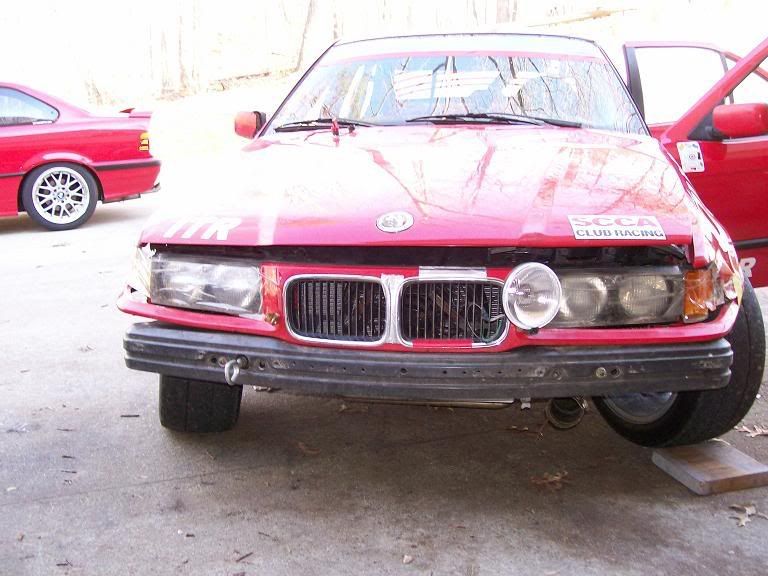

For a little history on the car, it was wrecked in the 13 hour charge of the headlight brigade at VIR. It's sponsored by UUC, Bimmerworld, and Eurobahn Motorsports. I started this restoration on 1-11-09 and completely finished it 2-19-09, I was rushed quite a bit to have it ready for CMP. If you saw it there not doing so great, it's because the front steering rack and tie rod assemblies weren't installed until 2-19-09 and there was no time to corner balance or set it up correctly. I'm working up a whole DIY, but it's epic long already and I'll only post it on here if I get several requests for one. So, for now I thought I could treat you guys to just a few pics of the project. Enjoy!
Not all of the sponsor stickers were on in the last pic, but it just needed to get to the track. If anyone has any questions feel free to post them in my thread instead of PM's for others to view. For all of the pics for the project, here's the link http://s386.photobucket.com/albums/oo307/rcrobbin/projects/?start=all.

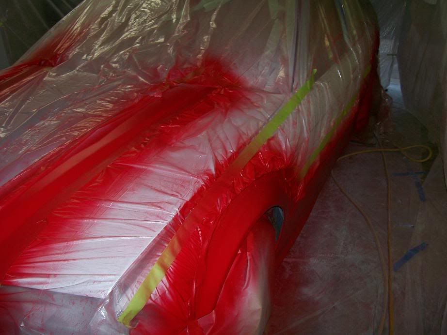

Thanks for the comments. I got the doors, trunk, and fenders for free from his parts car. He bought the M3 bumper from DDM and took almost 2 weeks to get in, even after he had called them and asked if they were in stock and could be shipped ASAP. It took around 300 hours total time involved and $600 in paint. He said it would've been fine to do just a crappy 1 stage, but I went all out with 2 stage. I used Diamont for the alpine weiss iii, hellrot and cosmos came from automotivetouchup.com, master pro 8900V clear. I put a lot of clear coats on it (4) for the added protection, but it didn't atomize well since it was kind of cheap which resulted in a lot of wet sanding and buffing. For future reference, I wasn't that impressed with Diamont. I've heard good things about it, it sprayed great, but the color just didn't have the vibrancy I was looking for and had bleed through issues (no I didn't over reduce it). Honestly, I wish I had more time to prep and paint the car, but I was on a deadline and that rear quarter gave me hell for about 3 weeks, and I painted it in about 3 days then had to piece it back together. Still, it's a track car, and the paint job is good enough for racing. On a side note- it did win 1st in it's class last weekend at CMP.
