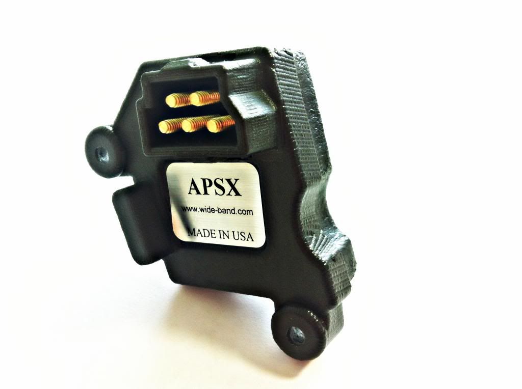

Next time please consider our product: APSX WB FSU: $39.99 free shipping in USA. Made in USA at wide-band.com
See less See more
Where are the pins <-WB->? :)
No pins. Please read about it on our website.
I'm not sure why we're not aware of this wide-band FSU replacement product, since a reading of the web page says all the right words about it being a better replacement part.
I know nothing about the wide-band FSU other than what's said on the web page, but, I like what I see so far.
For example, the wide-band FSU is apparently made in the USA.
It apparently doesn't get hotter than 40°C (104°F) so, maybe these solder cracks won't appear?
- How to repair solder cracks in your blower motor resistor (1)
Based on the web page, the wide-band FSU supposedly handles (a lot) more current than can the Behr original (30 amps versus 20 amps, despite the 30 Amp fuse #75:
- How to test the infamous fuse 75 (1)
Interestingly, at any one setting, the wide band FSU apparently causes the blower to blow more air (I guess that means higher current to the blower motor pins as described here):
- How to troubleshoot a bad FSU final stage unit (1) and how to build a test jig for your FSR final stage resistor (1)
One question for the wide-band folks ... you mention at high speeds the Wide Band FSU stays cooler than OEM, but, we've surmised (perhaps incorrectly?) that the lower speeds cause the highest power drop across the FSU.
- What setting to put your air conditioner blower motor fan control at to protect the FSU (1)
Is our assumption wrong?
