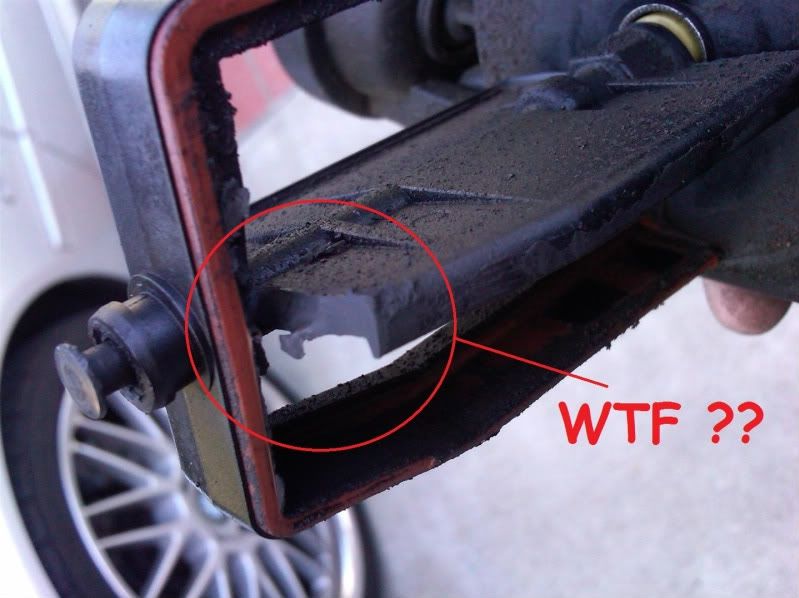

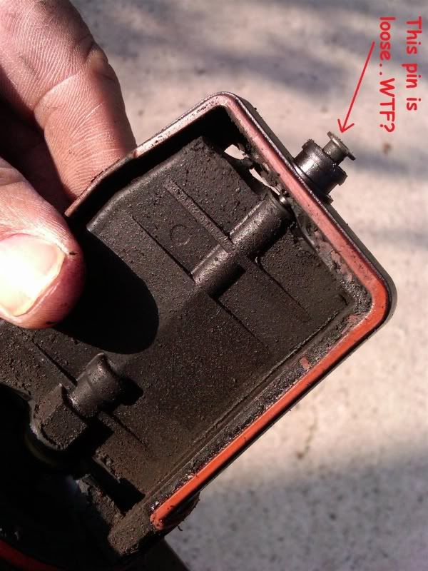

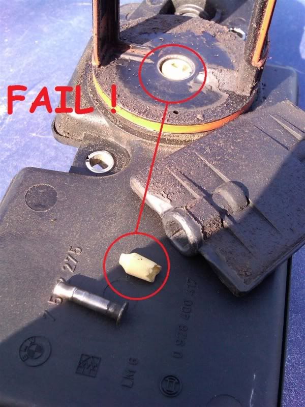

I had no codes, but I searched many threads and forums, and the P0304 & P0305 seemed associated with the DISA when stuck. I had a faint whirring when I pulled it out, the pin was halfway out....and the flapper had a bit of a "free" movement. It's 200 bux vs rebuilding the engine (sooner or later, depending on your luck).

I saw a video somewhere on how to test the vacuum on the valve. Move the flapper to the closed position, then block the vacuum hole with your finger. Release the flapper and it should not open all the way. It will stop in the middle position and wont open fully until you let go of your finger.

I wouldn't recommend rebuilding the DISA or doing a "band-aid" fix.
Nobody would disagree. The stakes are just too high. The engine is toast when the DISA fails. Yes, BMW is at fault; they make a garbage part; but your only choice is to replace old garbage with new garbage. That's why it makes no sense to pay two hundred dollars for BMW garbage - but it does make sense to replace BMW garbage.

Guess it was about 4 years ago mine was going south--Rajaie was over at the house and pointed the problem out to me. With the engine at idle you could lean over and place your left ear on the part and could hear it rattle. When you gave it a little gas the part would sound like all he%%ll was breaking loose inside. I removed the part and gutted the flapper and the housing around the flapper and then put it back on the engine. I drove it that way for about a week until the new one arrived. I could tell there was a little less tq on bottom end but it didn't make me feel unsafe and the car performed well out on the highway--no bucking or stumbling and decided that it doesn't or didn't hurt the engine as long as I didn't feel like going wide open--don't do that much anymore as I get closer to 60---dang I'm starting to feel old
