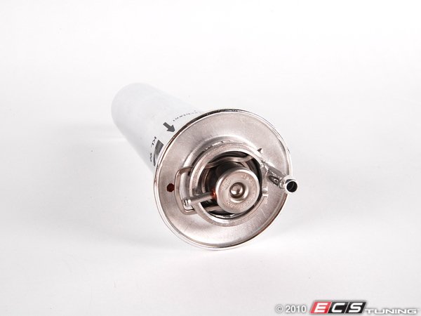

Searched the database for a fuel filter replacement DIY.
I thought this might be a good Maintenance procedure.
My guess I should get BMW fuel filter (rather than Mahle) with internal pressure regulator.
13321709535 Part number ECS Tuning
Recommendations?
