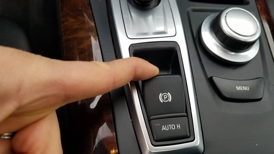

I'm not certain I did the "soft reset" correctly. Steps are: 1. Press and hold the parking pedal. 2. Turn on ignition 3. Press and hold the parking brake button for 5 seconds.
First off, what is a parking pedal? The brake pedal? If I press that and then turn on the ignition, the car will start. Assuming I want the ignition all the way on, but don't know that the car has to be running. And then is says press the button when it means pull the button? I read elsewhere to push for 5 seconds, rest for 1 second, pull for 5 seconds with the ignition on. Tried that. Didn't say anything about a pedal.
