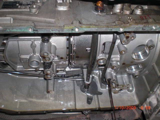

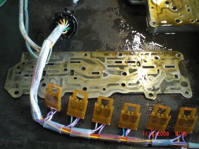

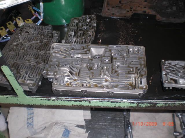

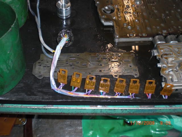

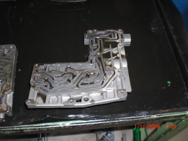

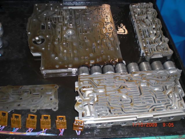

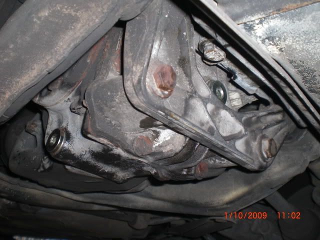

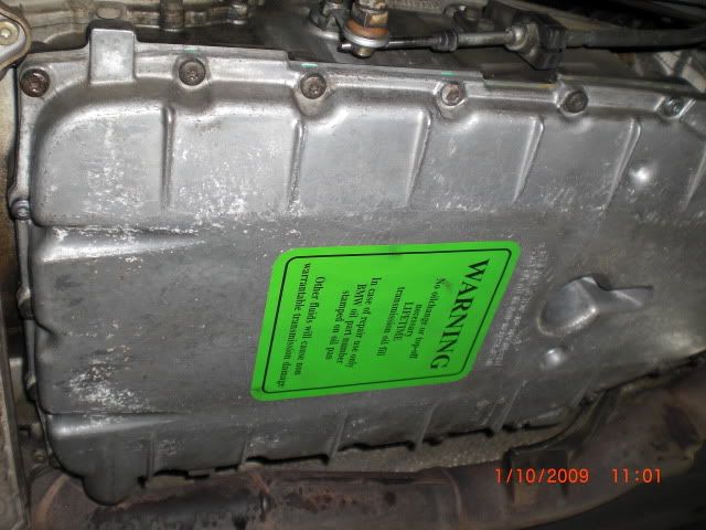

Together with a friend which owns a E34 540i we made an appointment with the manufacturer of the automatic transmission!
We did a full service @ ZF Dortmund in Germany...
Not just replacing the oil.. but a full service like it's supposed to..

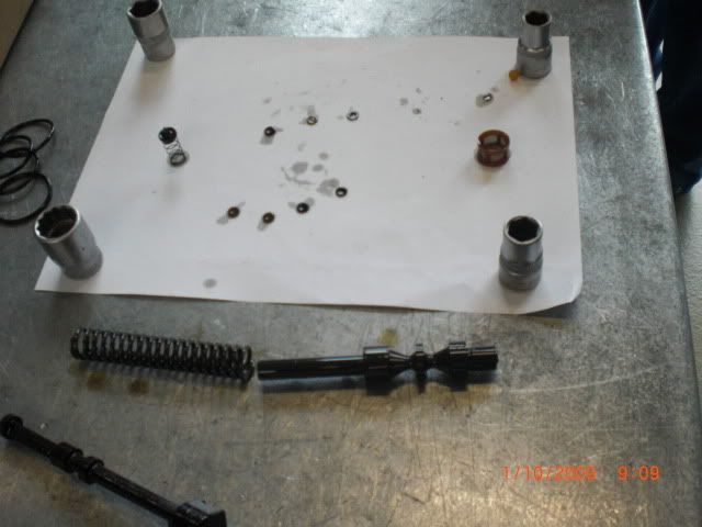

Got "wow-ed" by the service... While drinking a fresh cup of coffee they did a small revision.. on the aut.transmission and diff.!
Cleaning transmissions brain and replacing all springs,bearings etc. etc.
As an extra service they cleaned the diff. and changed the diff. oil replacing all plugs etc.
Pic's say more then words.....

BMW claims its long-life fluid....
Manufacturer (ZF) says.. 100 - 120.000 km's MAX>!...

I'm not sure how many miles but mine got the service done @ 225k KM.. Euh... 140k in Miles?
Everything you see and more on the picture with the white sheet is replaced (bearings,rings,filters and all gaskets) incl. the diff. gaskets and plugs.. everything is washed and cleaned!
