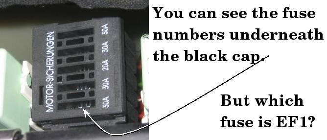

IN THE White E-BOX UNDER PASSENGER SIDE CABIN AIR FILTER:
EF1 = 30A, MAF, Cam sensor #1, DME, T-Stat, Evap emission valve (some say it's 30A - DME, Injectors, SMG Hydraulic unit)
EF2 = 30A, Fuel injectors, Both Vanos solenoids, Cam sensor #2, SAS pump electrical valve (some say it's 30A - DME, Idle control valve, Fuel tank ventilation valve, Fuel pump)
EF3 = 20A, Cam sensors, MAF, Crank Sensor, Heated O2 sensors (some say it's 30A, others say 25A - E-box fan, Transmission RPM sensor, CPS, MAF sensor, Fuel pump relay, SAP relay, A/C Compressor relay, Fuel tank leakage diagnostic module, SMG selector lever)
EF4 = 30A, DME (some say it's 30A - Oxygen sensors and oxygen sensor heater circuits)
EF5 = 30A, Unloader relay, power to coils (some say it's 30A - Fuel injector relay)
IMPORTANT: The five EF fuses are NOT labeled! Only the values are labeled, but they are symmetric!
It turns out (later in this thread) that EF1 is the left-most fuse (left being defined by being able to read the MOTOR-SICHERUNGEN (aka "engine security measures") printing on the fuse cover itself).
Note: There is a black or white cap enshrouding the five ebox fuses EF1 to EF5, which needs to be removed as explained by RDL in this thread.
