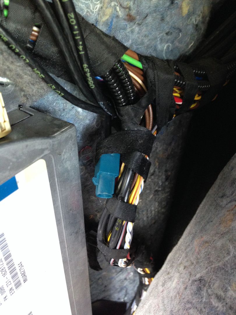

-"FAKRA" GPS antenna. (ebay, $15 or less if you're willing to wait on a shipment from China) - $15 (can be had for $5 if you're patient). Update 8/20/13: Not needed if you have CCC prep or CCC. See later posts about the connector in the trunk, TCU, etc.
