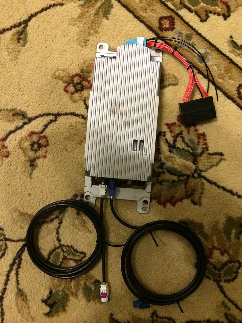

#205 ·
Harnesses are ready for testing.. I made three. The second one came out best I think--was running out of wire on the last one so had to make it short, lol. Detailed DIY coming in the next few days..

#214 · (Edited)
I went out and checked the four wires that come out of the larger 8-pin socket and plug into the 4 pin socket and into the new controller. I actually got an extra 4 pin socket and made up a jumper wire harness so I can just unplug the old, pull jumper out of the new 4 pin, and those 4 wires plug in to my new controller. Pin 1 is orange kcan, the + lead I think... Pin 2, that wire looks red to me and it's the other kcan lead, minus? When I connect my multimeter red lead to pin 1 and black lead to pin 2, I see +17v on my voltmeter. Pin 3 is ground (black wire) and pin 4 is power (yellow wire). When I connect my multimeter across pins 4 and 3, I see about +5v.
Hard to imagine that I would have 4 wires screwed up, and the car is working fine whenever I go back to the old controller. Basically, the orange-looking kcan wire is at one side, the yellow power wire is at the other...so the black ground and other kcan wire are in play? Help?
Here's a photo of a wiring schematic for the Controller. You can see the wire 1,2,4, and 5 and why those would be used in the newer controller as well. Question to figure is is all of those but the ground actually carry a signal. CAN H and CAN L for example...
