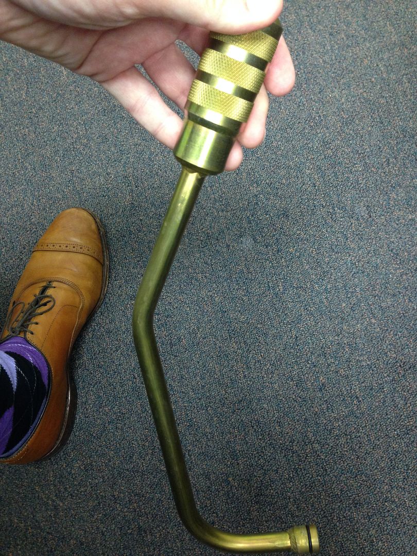

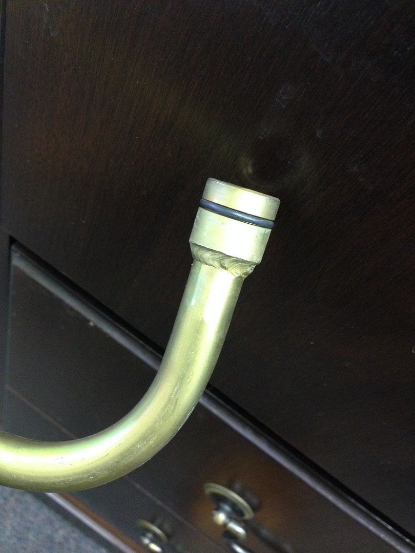

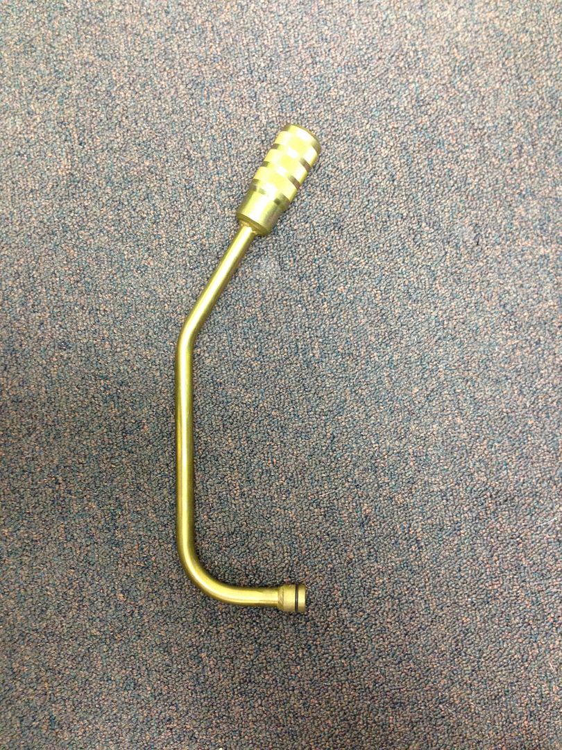

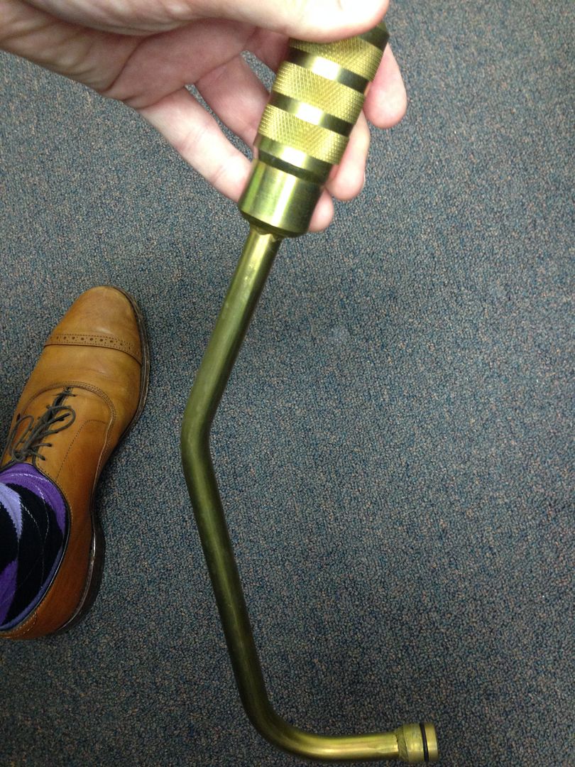

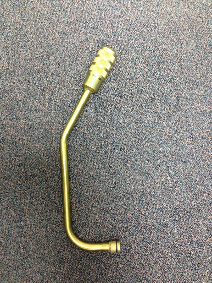

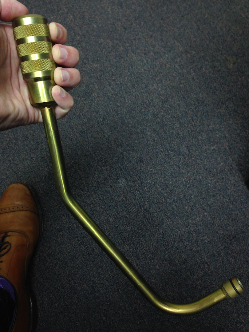

#10 · (Edited)
Pictures--will post my thoughts later. Running late for a hair cut!

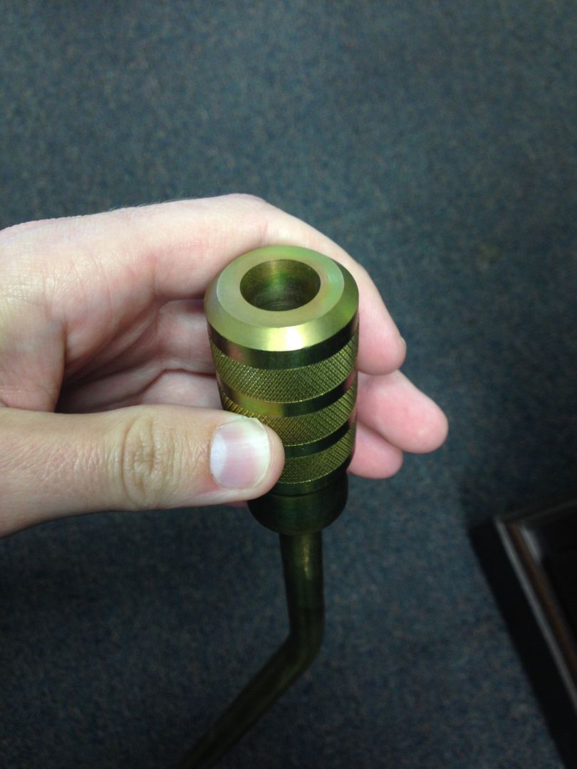

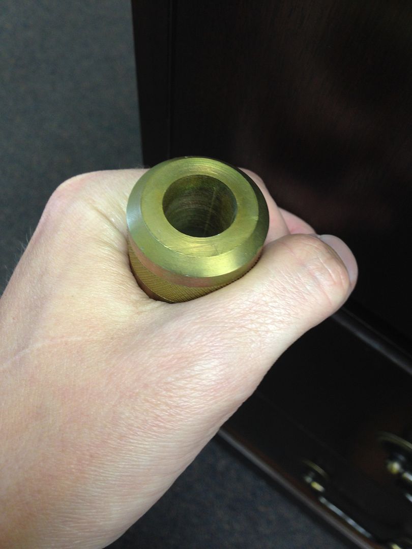

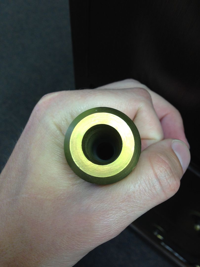

Here she is! This thing is much heavier than it looks. I was expecting some thin walled tubing or something with a bend and o-ring on it, but this thing is pretty stout feeling
Pretty solid piece--not sure what it's made out of, but I'm sure that $49 funnel will fit right into this opening!
Tapers down
O-Ring
Overall, I think it will do the job just fine--the problem is getting the metal tubes between the air valves and back of the engine off may be more trouble than it's worth. With those tubes on, you already have a decent point to pour a solvent in, and a decent place to put compressed air in (I think anyways, guess we'll see)
